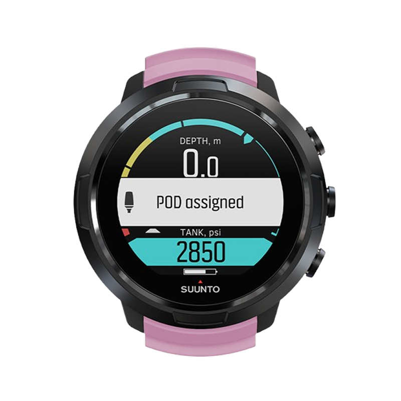

Suunto D5
Wildberry
An easy-to-use dive computer with interchangeable straps that fit your style. Made in Finland.

Suunto D5 is designed to be so clear and easy-to-use that you can just enjoy and focus on exploring the wonderful underwater world. When not diving, connect wirelessly to Suunto app and receive notifications from the applications you use. Play with style by choosing your favorite color or just by simply changing the straps to match your looks. Suunto D5 connects your two lives: the adventure under the surface but also the great experiences you can relive and share with your friends afterwards.

CONNECTIVITY
Connectivity (between devices)inductive (Tank POD), Bluetooth Smart

Wireless air integrationoptional (up to 3 different tanks with Suunto Tank POD)
